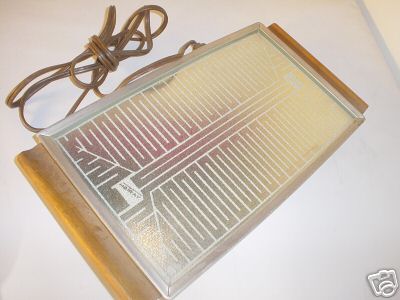

Not my personal experience, but I've read that it can be saved if starting to gel with a heat gun or hair dryer. I'd experiment with some scrap, in fact I think I will. To buy more assembly time, I bought a food warming tray, a big one 12"X18" with a temp control, got it at a thrift shop for $5. I just put my parts like braces, etc. on it for about 5 minutes to get them nice and toasty.

I meant to ask you before, you don't have a pic of your tray do you, I'm struggking to envisage what it is.

Not sure if these things are common to the UK. But they are/were used in the US at the dinner table to keep foods warm. Here's an eBay listing for one similar to mine. Maybe try eBay UK.
Another nice thing is that I keep it plugged in right on/next to my workbench, and I keep a bowl of heated water there too, for cleanups.

PostPosted: Wed Apr 05, 2006 9:39 am
Thanks Chris
Yes they are/were common I know it as a hot plate, thank for posting the picture Chris, that is a great idea.
